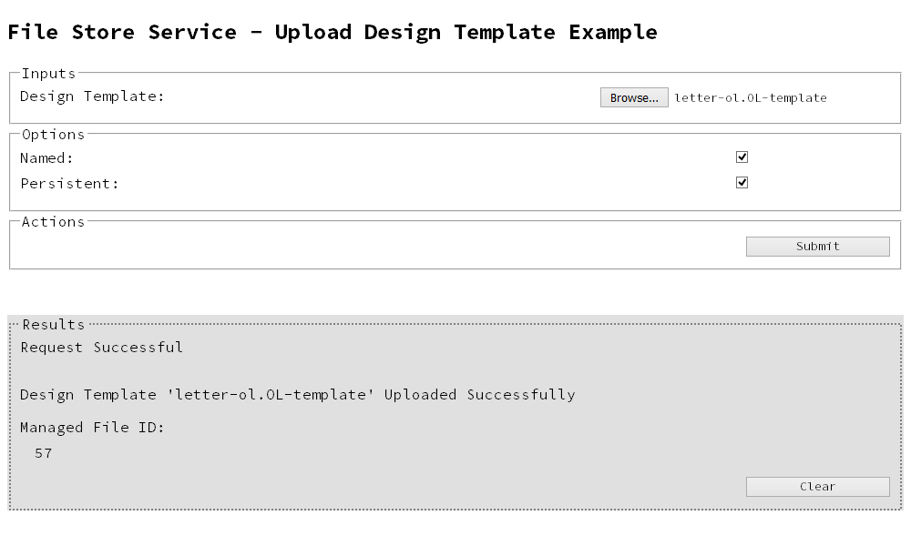

Screenshot & Output
Usage
To run the example simply select the Browse button and then select the design template you wish to upload using the selection dialog box.
Next you can specify the following options to use with the upload of the design template:
  • Named - allow this template to be identified/referenced by its Managed File Name as well as its Managed File ID
  • Persistent - make this template persistent in the file store
Once the template and options are selected, simply select the Submit button to upload the template to the server's file store and the resulting Managed File ID for the design template will be returned and displayed to the Results area.
