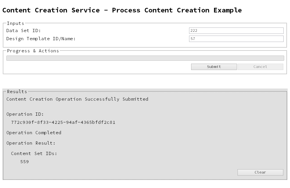

Screenshot & Output
Usage
To run the example simply enter the Data Set ID and the Managed File ID or Name of your design template (previously uploaded to the file store) into the appropriate text fields, and then select the Submit button to start the content creation operation.
The progress of the operation will be displayed in the progress bar, and once the content creation operation has completed, the IDs of the Content Sets created will be returned and displayed to the Results area.
