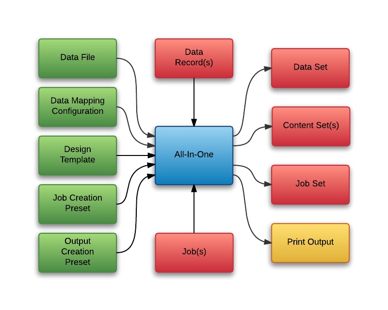

The All-In-One process embodies all four major workflow processes (data mapping, content creation, job creation and output creation) in a singular process. It can be configured to run one or more of the four processes, as long as the processes specified result in a logical sequence or workflow.
Depending on it's configuration, the All-In-One process can produce either a data set, content sets, a job set or print output (Print context).
The following diagram illustrates the potential inputs, outputs and workflows for the All-In-One process:
The following table lists the available processes, input combinations and expected outputs for the All-In-One process:
Processes Input Combination Expected Output
Data Mapping Only Data File + Data Mapping Configuration Data Set
Data Mapping + Content Creation Data File + Data Mapping Configuration + Design Template Content Set(s)
Content Creation Only Data Records + Design Template Content Set(s)
Data Mapping + Content Creation + Job Creation Data File + Data Mapping Configuration + Design Template Job Set
Content Creation + Job Creation Data Records + Design Template Job Set
Content Creation + Job Creation + Output Creation Data Records + Design Template + Output Creation Preset Print Output
Output Creation Only Jobs + Output Creation Preset Print Output
Data Mapping + Content Creation + Job Creation + Output Creation Data File + Data Mapping Configuration + Design Template + Output Creation Preset Print Output
Data Mapping + Content Creation + Job Creation + Output Creation Data File + Data Mapping Configuration + Design Template + Job Creation Preset + Output Creation Preset Print Output
