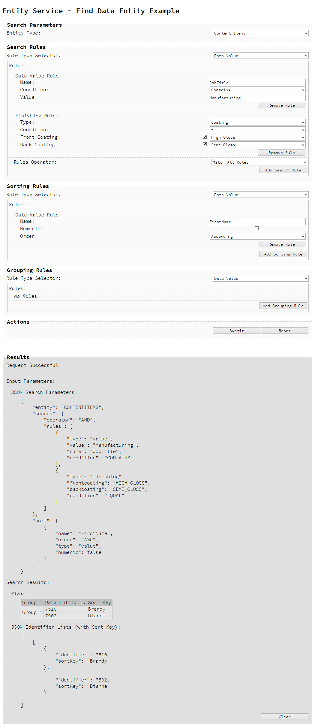

        <h2>Entity Service - Find Data Entity Example</h2>
        <form>
            <fieldset>
                <legend>Search Parameters</legend>
                <div>
                    <label for="entity">Entity Type:</label>
                    <select id="entity">
                        <option value="DATARECORDS">Data Records</option>
                        <option value="DATASETS">Data Sets</option>
                        <option value="CONTENTITEMS">Content Items</option>
                        <option value="CONTENTSETS">Content Sets</option>
                        <option value="JOBS">Jobs</option>
                        <option value="JOBSETS">Job Sets</option>
                    </select>
                </div>
            </fieldset>
            <fieldset id="search">
                <legend>Search Rules</legend>
                <div>
                    <label for="rule-type">Rule Type Selector:</label>
                    <select id="rule-type">
                        <option value="value">Data Value</option>
                        <option value="property">Property Value</option>
                        <option value="IN">In List</option>
                        <option value="NOT IN">Not In List</option>
                        <option value="finishing">Finishing</option>
                        <option value="doclength">Document Length</option>
                        <option value="templatename">Template Name</option>
                        <option value="group">Rule Group</option>
                    </select>
                </div>
                <div id="group" class="rule">
                    <label for="rule">Rules:</label>
                    <div id="rule" class="rule-body">
                        <div class="sub-rules">
                            <label>No Rules</label>
                        </div>
                        <div>
                            <label for="operator">Rules Operator:</label>
                            <select id="operator">
                                <option value="AND">Match All Rules</option>
                                <option value="OR">Match Any Rule</option>
                            </select>
                        </div>
                        <div>
                            <input id="add-search" type="button" value="Add Search Rule">
                        </div>
                    </div>
                </div>
            </fieldset>
            <fieldset id="sorting">
                <legend>Sorting Rules</legend>
                <div>
                    </select>
                </div>
                        </div>
                        <div>
                            <input id="add-sorting" type="button" value="Add Sorting Rule">
                        </div>
                    </div>
                </div>
            </fieldset>
            <fieldset id="grouping">
                <legend>Grouping Rules</legend>
                <div>
                    </select>
                </div>
                        </div>
                        <div>
                            <input id="add-grouping" type="button" value="Add Grouping Rule">
                        </div>
                    </div>
                </div>
            </fieldset>
            <fieldset>
                <legend>Actions</legend>
                <div>
                    <input id="reset" type="button" value="Reset">
                </div>
            </fieldset>
        </form>
    </body>
</html>

Screenshot & Output
Usage
To run the example first select the Entity Type that you are searching for. The data entity types available are:
  • Data Sets
  • Data Records
  • Content Sets
  • Content Items
  • Job Sets
  • Jobs
Once a data entity type is selected, various rules can be added to form the search criteria. There are three categories of rules available: search, sorting and grouping rules.
Search Rules
There are eight types of search rules that can be specified as part of the overall search criteria:
  • Data Value – Search for data entities based on the value of a data record field
  • Property Value – Search for data entities based on the value of a data entity property
  • In List – Restrict the search to the data entity identifiers contained within a list
  • Not In List – Restrict the search to data entity identifiers not contained within a list
  • Finishing – Search for data entities based on a finishing option:
    • Media Name – The name of a media used as defined in the PlanetPress Connect design template
    • Duplex – Whether the page sheet is duplex or not
    • Coating – The coating used for the front and back of the page sheet
    • Binding – The binding used for the document including style, edge, type & angle properties
  • Document Length – Search for data entities based on the document length (number of pages)
  • Template Name – Search for data entities based on the name of the design template used during Content Creation
  • Rule Group – Used to group search rules into logical groups (or sub-groups) and specifies a group rules operator that can be configured to either match all or any of the rules in the group
The types of search rules available are specific to the data entity type selected. The following table lists the available combinations:
Rule Type Data Records Data Sets Content Items Content Sets Jobs Job Sets
Data Value
Property Value
In List
Not In List
Finishing
Document Length
Template Name
Rule Group
Search rules can be added using the Add Search Rule button, removed using the Remove Rule button, and even re-ordered within the form.
Rules can be re-ordered by dragging and dropping a rule by it's name label (e.g. Data Value Rule: or Property Value Rule:).
Data Value search rules can be configured by specifying the following options:
  • Name – Name of the data record field to search by
  • Condition – Operator for the comparison of the data record field (e.g. Equals (=), Not Equals (<>), Less Than (<), Greater Than (>), etc.)
  • Value – Value of the data record field to match
Property Value search rules can be configured by specifying the following options:
  • Name – Name of the data entity property to search by
  • Condition – Operator for the comparison of the data entity property (e.g. Equals (=), Not Equals (<>), Less Than (<), Greater Than (>), etc.)
  • Value – Value of the data entity property to match
In List and Not In List search rules can be configured by specifying the following options:
  • Identifiers – List of data entity identifiers to match or not match against
Finishing search rules can be configured by specifying the following options:
  • Type – Type of finishing option to compare (e.g. Media Name, Duplex, Coating or Binding)
Finishing search rules with a Type set to Media Name can be further configured by specifying the following options:
  • Condition – Operator for the comparison of the media name (e.g. Equals (=) or Not Equals (<>))
  • Value – Value of the media name to match (e.g. Plain Letter Paper)
Finishing search rules with a Type set to Duplex can be further configured by specifying the following options:
Finishing search rules with a Type set to Coating can be further configured by specifying the following options:
  • Condition – Operator for the comparison of the coating (e.g. Equals (=) or Not Equals (<>))
  • Front Coating – The type of front coating to match (e.g. Semi Gloss, Satin, Matte, Glossy, None, etc.)
  • Back Coating – The type of back coating to match (e.g. Semi Gloss, Satin, Matte, Glossy, None, etc.)
Finishing search rules with a Type set to Binding can be further configured by specifying the following options:
  • Binding Style – The style of binding to match (e.g. Stapled, Glued, Stitched, Coil, etc.)
  • Binding Edge – The edge (or side on which the binding occurs) to match (e.g. Left, Right, Top or Bottom)
  • Binding Type – The type or location of the binding to match (e.g. Saddle, Side or Corner)
  • Binding Angle – The binding angle to match (e.g. Vertical, Horizontal or Angle)
Document Length search rules can be configured by specifying the following options:
  • Condition – Operator for the comparison of the document length (e.g. Equals (=), Not Equals (<>), Less Than (<), Greater Than (>), etc.)
  • Value – Value of the document length to match
Template Name search rules can be configured by specifying the following options:
  • Condition – Operator for the comparison of the template name (e.g. Equals (=) or Not Equals (<>))
  • Value – Value of the template name to match (e.g. letter-ol)
Rule Groups can be configured by specifying the following options:
  • Rules Operator – Operator for the matching of search rules contained in the group (e.g. Match All Rules (AND) or Match Any Rules (OR))
Rule Groups can be removed using the Remove Rule Group button, and in situations where removing a rule group would remove multiple rules, you will be prompted to confirm the removal of the rule group.
Lastly, select the Rules Operator for the matching of search rules contained in the base rules list (e.g. Match All Rules (AND) or Match Any Rules (OR))
Sorting Rules
There are also two types of sorting rules that can be used as part of the overall search criteria:
  • Data Value – Sort the search results by the value of a data record field
  • Property Value – Sort the search results by the value of a data entity property
The types of sorting rules available are also specific to the data entity type selected. The following table lists the available combinations:
Data Value
Property Value
Sorting rules can be added using the Add Sorting Rule button, removed using the Remove Rule button, and even re-ordered within the form.
Data Value sorting rules can be configured by specifying the following options:
  • Name – Name of the data record field to sort the search results by
  • Numeric – Sort the search results for this data record field numerically
  • Order – Sort the search results for this data record field in a specific order (e.g. Ascending or Descending)
Property Value sorting rules can be configured by specifying the following options:
  • Name – Name of the data entity property to sort the search results by
  • Order – Sort the search results for this data entity property in a specific order (e.g. Ascending or Descending)
Grouping Rules
There are also two types of grouping rules that can be used as part of the overall search criteria:
  • Data Value – Group the search results by the value of a data record field
  • Property Value – Group the search results by the value of a data entity property
The types of grouping rules available are also specific to the data entity type selected. The following table lists the available combinations:
Data Value
Property Value
Grouping rules can be added using the Add Grouping Rule button, removed using the Remove Rule button, and even re-ordered within the form.
Data Value grouping rules can be configured by specifying the following options:
  • Name – Name of the data record field to group the search results by
  • Numeric – Group the search results for this data record field numerically
  • Order – Group the search results for this data record field in a specific order (e.g. Ascending or Descending)
Property Value grouping rules can be configured by specifying the following options:
  • Name – Name of the data entity property to group the search results by
  • Order – Group the search results for this data entity property in a specific order (e.g. Ascending or Descending)
By default, comparison conditions in search rules are evaluated alphanumerically, regardless of the type of value.
Numeric evaluation of comparison conditions is not currently supported in the PlanetPress Connect REST API.
The only exception to this rule is the ability to numerically sort or group results by specifying sorting or grouping rules of a Data Value type.
The Entity Type selected for the search criteria can be changed during or even after rules have been added. But because certain rules are only available for certain data entity types, some of the existing rules in the search criteria may become incompatible.
In situations where incompatible rules are found in the existing search criteria, you will be prompted to confirm the change of entity type. If you then proceed with the change of entity type, any incompatible rules found in the existing search criteria will be removed.
Once the search criteria is constructed, and the required inputs populated, simply select the Submit button. This will submit the request to the server and display the search criteria specified as input to the Results area in JSON Search Parameters format.
The result will then be returned as a list of Data Entity IDs which will be appended to the Results area in both Plain table and JSON Identifier Lists (with Sort Key) formats.
To construct a new search criteria, the Reset button can be selected. This will reset the form, removing all existing rules.
Further Reading
See the Entity Service page of the REST API Reference section for further detail.
