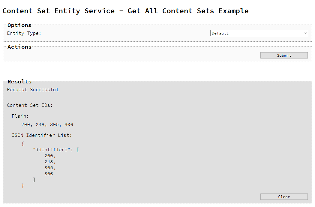

Screenshot & Output
Usage
To run the example simply select the Submit button to request a list of the all the content sets currently contained within the server.
The resulting list will then be returned and displayed to the Results area in both Plain list and JSON Identifier List formats.
