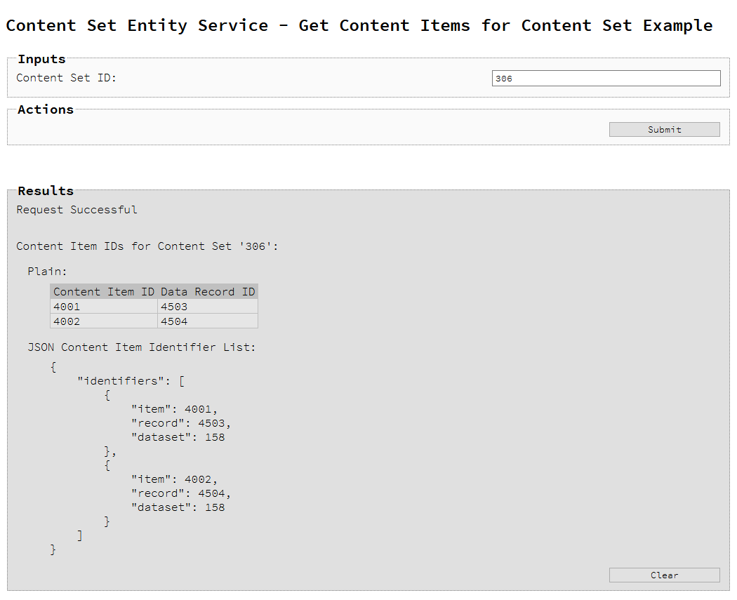

Screenshot & Output
Usage
To run the example simply enter the Content Set ID and select the Submit button to request a list of the all the content items contained within the specific content set in the server.
The resulting list will then be returned as a list of Content Item and Data Record ID pairs which will be displayed to the Results area in both Plain table and JSON Content Item Identifier List formats.
