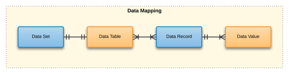

The following diagram illustrates the basic relationship between these entities in the context of the data mapping process:
_thumb_0_150.png)
The data set and data record entities (shown above in blue) are accessible via the Data Set Entity and Data Record Entity services.

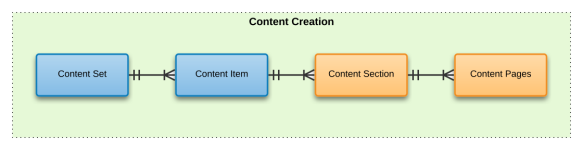

The following diagram illustrates the basic relationship between these entities in the context of the content creation process:
_thumb_0_150.png)
The content set and content item entities (shown above in blue) are accessible via the Content Set Entity and Content Item Entity services.

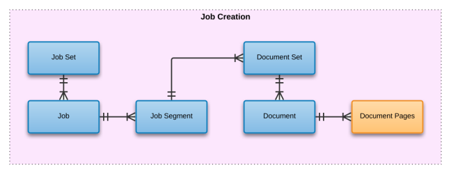

The following diagram illustrates the basic relationship between these entities in the context of the job creation process:
_thumb_0_250.png)
The job set and job entities (shown above in blue) are accessible via the Job Set Entity and Job Entity services. The job segment, document set and document entities (also shown above in blue) are accessible via the Job Segment Entity, Document Set Entity and Document Entity services.

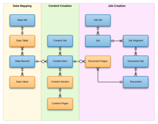

In summary, the following diagram illustrates the basic relationship between all data entities in the overall context of the primary workflow in PlanetPress Connect:
_thumb_0_250.png)
