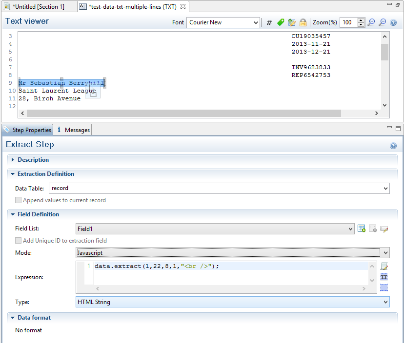

extract(left, right, verticalOffset, regionHeight, separator)
Extracts a value from a position in a text file. Coordinates are expressed as characters (horizontally) or lines (vertically).
left
Number that represents the distance, measured in characters, from the left edge of the page to the left edge of the rectangular region. The leftmost character is character 1.
right
Number that represents the distance, measured in characters, from the left edge of the page to the right edge of the rectangular region.
verticalOffset
Number that represents the current vertical position, measured in lines.
regionHeight
Number that represents the total height of the region, measured in lines.
separator
String inserted between all lines returned from the region. If you don't want anything to be inserted between the lines, specify an empty string ("").
"<br/>" is a very handy string to use as a separator. When the extracted data is inserted in a Designer template, "<br/>" will be interpreted as a line break, because <br/> is a line break in HTML and Designer templates are actually HTML files.
Examples
Example 1:
The script command data.extract(1,22,8,1,"<br />"); means that the left position of the extracted information is located at character 1, the right position at character 22, the offset position is 8 (since the line number is 9) and the regionHeight is 1 (to select only 1 line). Finally, the "<br/>" string is used for concatenation.

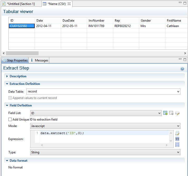

extract(columnName, rowOffset)
Extracts the text value from the specified column and row.
columnName
String that represents the column name.
rowOffset
Number that represents the row index (zero-based), relative to the first row in the record. To extract the first row, specify 0 as the rowOffset.
Example
The script command data.extract('ID',0); means that the extraction is made on the ID column in the first row.
