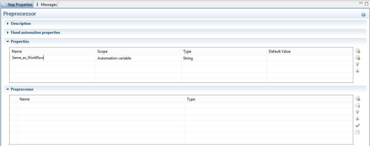

Accessing automation properties
To make a Workflow variable accessible in scripts, it must first be declared in the Properties of the Preprocessor step (see Properties). Both the name and type of the variable must be the same as the variable in Workflow.
The other properties are accessible as they are.

To access Workflow variables (declared in the Preprocessor properties):
automation.variables.Same_as_workflow;
