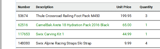

The Designer Scripts API provides several functions to style elements, for example Styling based on a value in a detail tableStyling rows or cells in a detail table based on a value in the detail table goes a bit different. First set an ID on the detail table as a whole and create a script that uses for(var i = 0; i < record.tables.detail.length; i++){
if(record.tables.detail[i].fields['Shipped'] == 1)
query("tr:nth-child(" + (i+1) + ")", results).css('color','green');
This script loops over a detail table, evaluating the field To keep all CSS style rules together you could add the style rules to a class in the CSS file (see Styling templates with CSS files) and assign that class to the a row or cell using For another example, see this how-to: Change detail line formatting based upon a data field value. |
