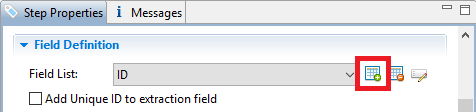

Via the Step properties pane
  1. Select an Extract step on the Steps pane. (To add a new, empty Extract step, right-click the Steps pane and select Add a Step > Add Extraction.)
  2. On the Step properties pane, under Field Definition, click the Add JavaScript Field button next to the Field List.
  3. On the Step properties pane, under Field Definition, enter the script in the Expression field.

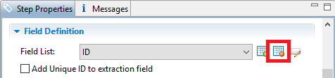

The list of fields that are included in an extraction is one of the properties of an Extract step. To delete a field:
  1. Select the field: click on the field in the Data Model, or select the Extract step that contains the field that you want to delete, and in the Step properties pane, under Field Definition, select the field from the Field List.
  2. In the Step properties pane, under Field Definition, click the Remove Extract Field button next to the Field List drop-down.
