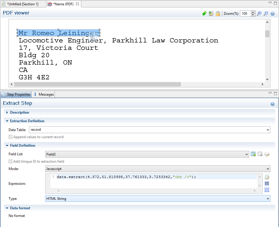

extract(left, right, verticalOffset, lineHeight, separator)
Extracts the text value from a rectangular region in a PDF file. All coordinates are expressed in millimeters.
left
Double that represents the distance from the left edge of the page to the left edge of the rectangular region.
right
Double that represents the distance from the left edge of the page to the right edge of the rectangular region.
verticalOffset
Double that represents the distance from the current vertical position.
lineHeight
Double that represents the total height of the region.
separator
String inserted between all lines returned from the region. If you don't want anything to be inserted between the lines, specify an empty string ("").
"<br/>" is a very handy string to use as a separator. When the extracted data is inserted in a Designer template, it will be interpreted as a line break, because <br/> is a line break in HTML and Designer templates are actually HTML files.
Example
The script command data.extract(4.572,51.815998,37.761333,3.7253342,"<br />"); means that the left position of the extracted information is located at 4.572mm, the right position at 51.815998mm, the vertical offset is 37.761333mm and the line height is 3.7253342mm. Finally, the "<br/>" string is used for concatenation.
