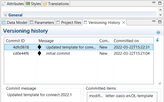

Versioned Projects
You can create versioned projects. A versioned project retains a record of the changes made to any file in the project. You can review changes, and also revert to a previous version of a project, if necessary.
As you work on your project files, you can commit the files in the project at any time. When you commit the project, a snapshot of the project is saved as a version. Any additional information associated with a resource in the project is recorded alongside the file.
Use the Project Files option in the Project menu to display the list of resources in the project.
The files comprising a Project display in the Project Files panel.
Use the Versioning History option in the Project menu to display the history of all changes. The Versioning History panel contains a complete record of who did what, on which date, and for which reason.
You can elect to revert to a version from within the history if something turns out to be flawed in your current project.
Both the Designer and the DataMapper use Git integration to maintain the history of a Project.
