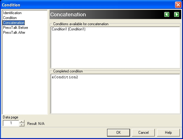

To combine global conditions using the Condition properties dialog box:
  1. In the Structure area, double-click the condition to open the Condition properties dialog box for the condition with which you want to combine one or more existing conditions:
  2. In the Condition properties dialog box, click Concatenation.
    The name of the condition you are defining appears in the Completed condition box, and the names of the conditions you can combine with it appear in the Conditions available for concatenation box.
  3. Do one or more of the following to combine conditions into a valid Boolean expression. As you work, PlanetPress Design reports any syntax errors in the Status area.
    A. Status area
    • Type directly in the Completed condition box. Names of conditions and Boolean operators are both case-insensitive. Note that if you want to use a NOT operator, you must enclose the condition on which you want it to operate in parenthesis. Thus you enter NOT (&black) rather than NOT &black.
    • Drag and drop conditions from the Conditions available for concatenation box. Click on the name of the condition you want to add, drag it to the Completed condition box, release it at the position at which you want to insert it in the expression, and choose either And or Or from the menu PlanetPress Design displays. Legal positions for insertions are displayed in blue as you drag. Releasing over a condition name inserts the condition after that condition. Releasing over an opening parenthesis inserts the condition before that opening parenthesis. Releasing over a closing parenthesis inserts the condition after that closing parenthesis.
    • Apply the NOT operator to a condition by right-clicking the condition and choosing Insert “Not” Operator. PlanetPress Design encloses the expression on which you clicked in parentheses, and precedes it by the NOT operator.
    • Remove the NOT operator from a condition by right-clicking the condition and choosing Remove “Not” Operator.
    • Delete a condition by right-clicking the condition and choosing Delete Item from Condition. Note that you cannot delete the condition you are currently defining.
    • Delete any or all conditions by highlighting the section you want to delete and pressing BACKSPACE, or by backspacing through the section.
  4. Click OK.
    If the Boolean expression contains a syntax error and you attempt to close the Condition properties dialog box, PlanetPress Design returns the focus to the Concatenation area of the Condition properties dialog box. You must fix the error to close the dialog box.
