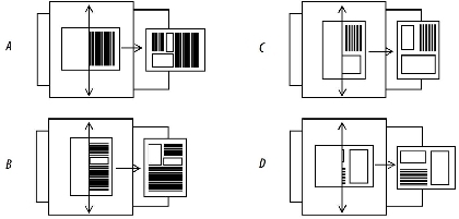

As examples of correct scanline orientation settings, consider a document that uses an 8.5x11 inch sheet of paper. In the diagram, the vertical double-headed arrow represents the scanline of the printer, and the paper is moving through the printer from left to right.
A. Images scanned from top to bottom on a page in portrait orientation B. Images scanned from side to side in portrait orientation C. Images scanned from top to bottom in landscape orientation D. Images scanned from side to side in landscape orientation
In cases A and C, you set the scanline orientation of each of the bitmapped image resources on the page to Top to bottom. In cases B and D, you set the scanline orientation to Side to side.
