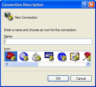

      The Connection Description dialog box appears.
    2. In the Name box, enter a name for the connection and click OK.

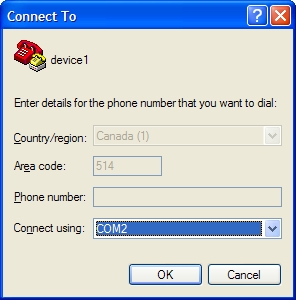

      The Connect To dialog box appears.
    3. Select COM 1 or COM 2 and click OK. If you need to determine which COM port the printer uses, open the Control Panel, then open Modems and click Diagnostics. In most cases you select COM2. The remaining steps of this procedure assume you selected COM2.

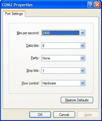

      The COM2 Properties dialog box appears.
    4. Adjust the COM2 Properties and click OK.

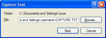

      The Capture Text dialog box appears.
    6. The file name that appears in this dialog box is Capture.txt. If this file does not exist, you will need to create it (this is the text file that will be used as the capture file).
    7. Click Start.
