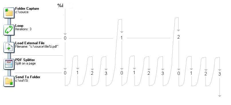

The %i Loop Count variable
The value of the %i variable is equivalent to the current iteration of loops inside of a process. It always contains the value of the innermost loop, and only certain tasks trigger the counter to start. The below image shows an example process and the value of %i during this process:
Initial input tasks do not modify the value of %i. However, the following tasks do trigger the variable:
  • Barcode scan
  • Capture Field Processor
  • All Splitters (Including the Metadata Sequencer)
  • Get Capture Document
  • Loop
  • Capture PGC Splitter
  • PrintShop Mail
