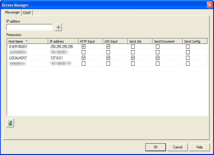

The Access Manager controls what rights are granted to other machines (clients and servers) on the same network. It grants access to functions such as sending documents and jobs to the server.
Messenger communications (between different part of the PlanetPress Suite) is limited to within the same Class C subnet. This means that PlanetPress Workflow on 192.168.1.23 cannot send a job to a PlanetPress Image on 192.168.100.54. This limitation has been removed in PlanetPress Suite 7.3 and higher.
To open the Access Manager
The Access Manager dialog box is displayed. It lists all IP and IP ranges that have PlanetPress Design, PlanetPress Workflow, PlanetPress Fax or PlanetPress Image installed in the same network.
To manually add a new entry in the list
The format of the IP address must be one of the following:
To automatically detect machines on the network and add them
To remove an entry in the list
The following considerations are to be understood when using the Access Manager to configure IP limitations:
To modify permissions
Permissions are given simply by adding and removing options in the permission grid. Access to the services installed on this computer is granted or denied by checking the corresponding boxes next to the listed IP ranges. For each IP range, the following information is displayed:
In order for the changes made here to be effective, you will need to restart the PlanetPress Messenger service. This can be done via the PlanetPress Suite Service Console.

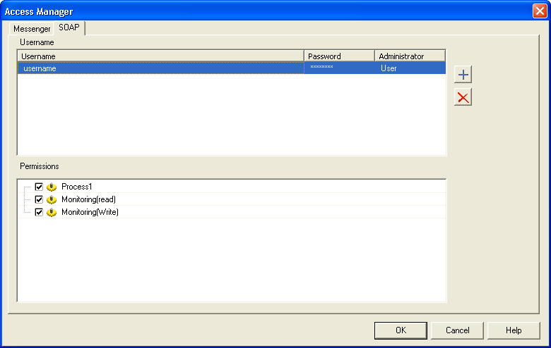

SOAP Access
The SOAP tab of the Access Manager controls access from SOAP clients to local processes and SOAP processes. Each username entered in this dialog can have access to one or more processes.
To add a new SOAP user
To define or change the permissions for a SOAP User
The Permissions section of the SOAP tab displays all of the processes that are available in the live configuration (the one that the PlanetPress service uses). To change or define the permissions:
