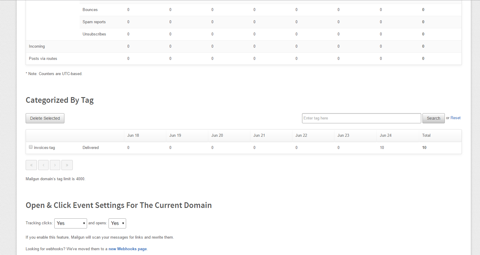

M​ailGun
Dashboard: https://mailgun.com/cp/stats
Documentation: https://documentation.mailgun.com/api-sending.html#sending
Write a Control Script that adds a header with the name X-Mailgun-Tag and sets its content (for example: invoices).
For example:
Copy
merge.context.sections["Content"].addHeader("X-Mailgun-Tag", "invoices");
You may specify multiple categories, as follows:
Copy
var headerObj = {
"category": [
"dogs",
"animals",
"pets",
"mammals"
var section = merge.context.sections["Content"];
section.addHeader("X-Mailgun-Tag", JSON.stringify(headerObj));
Note: The Mailgun tag allows you to view the stats per tag. Mailgun has a quick refresh and stats are available almost instantly.
