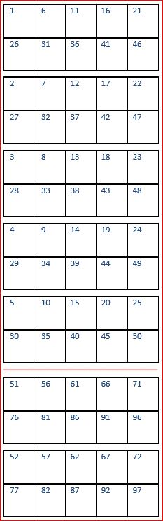

Stack Depth selection: Stack Depth defines the number of Imposition Sheets that will be printed before drill sorting resets.
Stack Depth works in conjunction with the Horizontal and Vertical page, Gap and Page Order selections in order to determine the printing order. This is best illustrated by way of example.
The following "Cut and stack" example has a job with 100 single page documents and repetition settings of 5 Horizontal and 2 Vertical, plus a Stack Depth of 5.
Each table represents a single Imposition Sheet, and the red line between the tables represents the Stack Depth:
Each set of 5 Imposition Sheets is a discrete drill sorted nUp block that can be guillotined and stacked. The first 5 sheets encompass records 1-50, whilst the next 5 sheets encompass records 51-100.

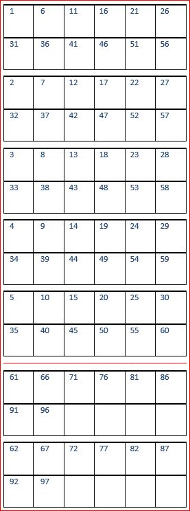

The following example is the same job but with a Horizontal repetition setting of 6:
As you can see, the outputs are very different.Note: If the Stack Depth is greater than the number of sheets in the entire job then you will get a single drill sorted block that can be guillotined and stacked to give the complete job in record order.
