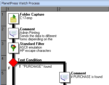

Granted that you have backup copies of the files polled by an Input task, you may resubmit them as required. The PlanetPress Workflow Configuration tool gives you the option to resubmit them as they were submitted originally (polled by the initial input task) or to submit them to those tasks located on the index you select.
The numbers on the left in the Process area indicate the task index.
In the above image, the Folder Capture task is on level 1 and the Text condition is on level 4.
