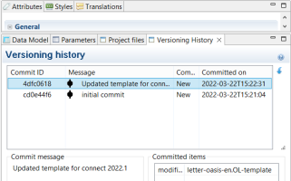

Project Versions
Version control automatically retains a record of the changes made to any file in a project. You can review changes, and also revert to a previous version of a project, if necessary.
Each time you commit a resource (i.e., when you save an updated version of it), any additional information provided gets recorded alongside the file.
Use the Project menu to display the Project Files panel and the Project Files panel.
The files comprising a Project can be viewed in the Project Files panel.
You can browse through the history of all changes in the Versioning History panel, which contains a complete record of who did what, on which date, and for which reason.
You can elect to revert to a version from within the history if something turns out to be flawed in your current project.
Both the Designer and the DataMapper use Git integration to maintain the history of a Project.
