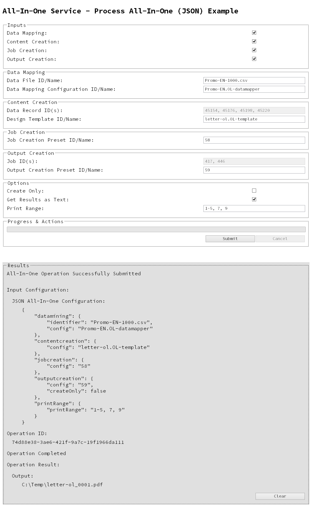

Example
HTML5
aio-process-json.html
<!DOCTYPE html>
<html>
    <head>
        <meta charset="utf-8">
        <title>Process All-In-One (JSON) Example</title>
        <script src="js/aio-process-json.js"></script>
    </head>
    <body>
        <h2>All-In-One Service - Process All-In-One (JSON) Example</h2>
        <form>
            <fieldset id="inputs">
                <legend>Inputs</legend>
                <div>
                    <label for="datamining">Data Mapping:</label>
                    <input id="datamining" type="checkbox">
                </div>
                <div>
                    <label for="contentcreation">Content Creation:</label>
                    <input id="contentcreation" type="checkbox">
                </div>
                <div>
                    <label for="jobcreation">Job Creation:</label>
                    <input id="jobcreation" type="checkbox">
                </div>
                <div>
                    <label for="outputcreation">Output Creation:</label>
                    <input id="outputcreation" type="checkbox">
                </div>
            </fieldset>
            <fieldset id="datamining-inputs" disabled>
                <legend>Data Mapping</legend>
                <div>
                    <label for="datafile">Data File ID/Name:</label>
                    <input id="datafile" type="text" placeholder="1234 or Filename" required>
                </div>
                <div>
                    <label for="datamapper">Data Mapping Configuration ID/Name:</label>
                    <input id="datamapper" type="text" placeholder="1234 or Filename" required>
                </div>
            </fieldset>
            <fieldset id="contentcreation-inputs" disabled>
                <legend>Content Creation</legend>
                <div>
                    <label for="datarecords">Data Record ID(s):</label>
                    <input id="datarecords" type="text" placeholder="1234, 2345, 3456, ..." required>
                </div>
                <div>
                    <label for="designtemplate">Design Template ID/Name:</label>
                    <input id="designtemplate" type="text" placeholder="1234 or Filename" required>
                </div>
            </fieldset>
            <fieldset id="jobcreation-inputs" disabled>
                <legend>Job Creation</legend>
                <div>
                    <label for="jcpreset">Job Creation Preset ID/Name:</label>
                    <input id="jcpreset" type="text" placeholder="1234 or Filename" disabled>
                </div>
            </fieldset>
            <fieldset id="outputcreation-inputs" disabled>
                <legend>Output Creation</legend>
                <div>
                    <label for="jobs">Job ID(s):</label>
                    <input id="jobs" type="text" placeholder="1234, 2345, 3456, ..." required>
                </div>
                <div>
                    <label for="ocpreset">Output Creation Preset ID/Name:</label>
                    <input id="ocpreset" type="text" placeholder="1234 or Filename" required>
                </div>
            </fieldset>
            <fieldset>
                <legend>Options</legend>
                <div>
                    <label for="createonly">Create Only:</label>
                    <input id="createonly" type="checkbox" disabled>
                </div>
                <div>
                    <label for="resultstxt">Get Results as Text:</label>
                    <input id="resultstxt" type="checkbox" disabled>
                </div>
                <div>
                    <label for="printrange">Print Range:</label>
                    <input id="printrange" type="text" placeholder="1, 2, 3-5, 6" disabled>
                </div>
            </fieldset>
            <fieldset>
                <div>
                </div>
                <div>
                </div>
            </fieldset>
        </form>
    </body>
</html>

            /* Process All-In-One (JSON) */
            $.ajax({
                type:           "POST",
                url:            "/rest/serverengine/workflow/print/submit",
                data:           JSON.stringify(AIOConfig),
                contentType:    "application/json"
            }).done(function (response, status, request) {
                var progress  = null;
                $submitButton.attr("disabled", "disabled");

Screenshot & Output
Usage
To run the example simply select the input combination of your choosing, populate the appropriate input fields and then check any options that you may require.
The following file based input fields can be referenced by Managed File ID or Name:
  • Data file
  • Data Mapping configuration
  • Design template
  • Job Creation preset
  • Output Creation preset
The following options are only available if the input combination includes an output creation step:
  • Create Only - Create the output in server but do not send spool file to its final destination. In this example this would mean that the output files(s) would not be sent to the output directory specified in the output creation preset.
  • Get Results as Text - Return the result as text specifically. If our All-In-One Configuration includes an output creation step, then in this example this would return the absolute path to the output file(s).
  • Print Range - Restrict the printed output to a specific range of records in the input data, not a specific range of pages (requires combination with all workflow steps).
Lastly, select the Submit button to start the All-In-One operation.
Once the operation has started processing, the JSON All-In-One Configuration along with the Operation ID will be displayed in the Results area and the Cancel button will become enabled, giving you the option to cancel the running operation.
The progress of the operation will be displayed in the progress bar, and once the All-in-One operation has completed, the result will be returned and displayed to the Results area.
If the All-In-One configuration includes a output creation step, then the result returned will be the output files (either their absolute path(s) or the output file itself). If the configuration does not include an output creation step, then the result returned will be either a Data Set ID, Content Set IDs or Job Set ID.
If the result returned is expected to be file data, then the value <<OCTET-STREAM FILE DATA>> will be displayed.
