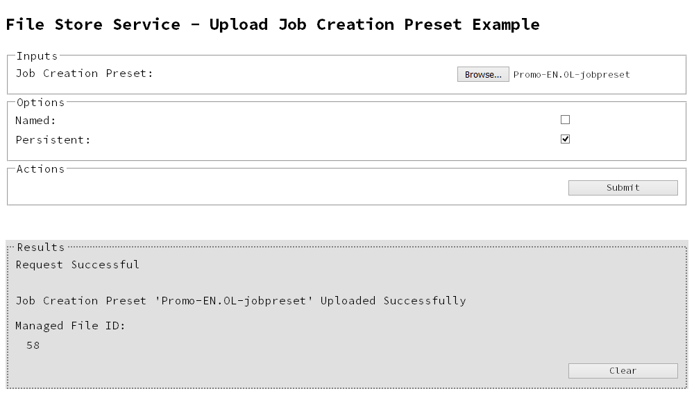

Screenshot & Output
Usage
To run the example simply select the Browse button and then select the job creation preset you wish to upload using the selection dialog box.
Next you can specify the following options to use with the upload of the job creation preset:
  • Named - allow this preset to be identified/referenced by its Managed File Name as well as its Managed File ID
  • Persistent - make this preset persistent in the file store
Once the preset and options are selected, simply select the Submit button to upload the preset to the server's file store and the resulting Managed File ID for the job creation preset will be returned and displayed to the Results area.
Discussion
When our event handler function is called, we then obtain a reference to the local job creation preset previously selected. This is achieved by getting the first value of the files attribute of the HTML element with the ID of jcpreset (in this case a file type input HTML element) and storing it in a variable file.
Method type and url arguments are specified as shown earlier, with the addition of a persistent query parameter which specifies whether the preset is to be persistent in the file store when uploaded.
We specify the variable file as the data or contents of the request, a contentType argument of "application/xml", and because we are sending file data we also specify a processData argument set to false.
If the Named option is checked in our form, and the named variable is true, then a filename query parameter is also added which contains the file name of the preset selected (file.name).
When the request is successful or done, a request response is received and the content of that response is passed as the function parameter response. In the example, we then display the value of this parameter which should be the new Managed File ID of the job creation preset in the file store.
