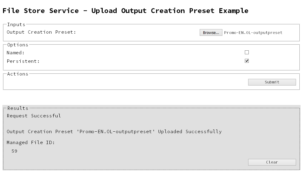

Screenshot & Output
Usage
To run the example simply select the Browse button and then select the output creation preset you wish to upload using the selection dialog box.
Next you can specify the following options to use with the upload of the output creation preset:
  • Named - allow this preset to be identified/referenced by its Managed File Name as well as its Managed File ID
  • Persistent - make this preset persistent in the file store
Once the preset and options are selected, simply select the Submit button to upload the preset to the server's file store and the resulting Managed File ID for the output creation preset will be returned and displayed to the Results area.
