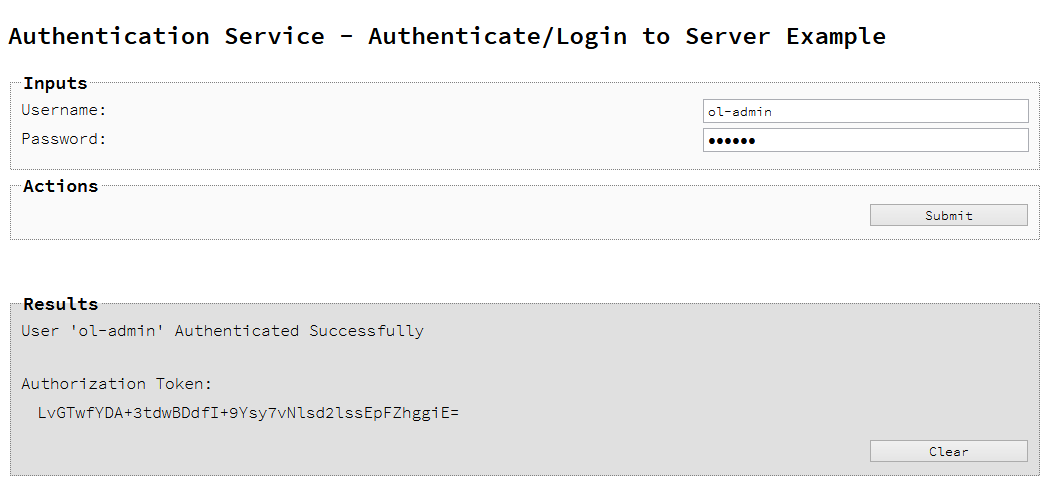

Screenshot & Output
Usage
To run the example simply enter your credentials into the Username and Password fields and select the Submit button.
Once selected, a request containing the credentials will be sent to the server and the result will be returned and displayed to the Results area.
If authentication was successful then the response will contain an Authorization Token that can be then used in the submission of future requests to the server.
