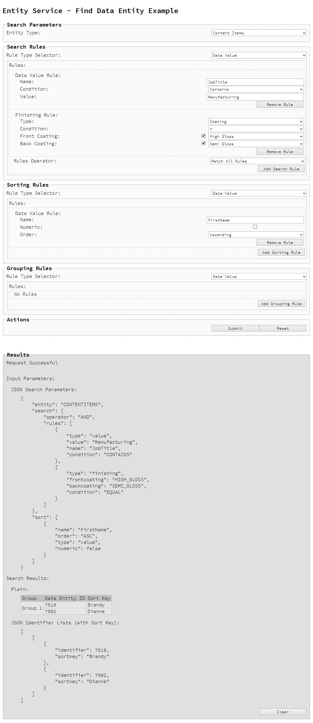

        <h2>Entity Service - Find Data Entity Example</h2>
        <form>
            <fieldset>
                <legend>Search Parameters</legend>
                <div>
                    <label for="entity">Entity Type:</label>
                    <select id="entity">
                        <option value="DATARECORDS">Data Records</option>
                        <option value="DATASETS">Data Sets</option>
                        <option value="CONTENTITEMS">Content Items</option>
                        <option value="CONTENTSETS">Content Sets</option>
                        <option value="JOBS">Jobs</option>
                        <option value="JOBSETS">Job Sets</option>
                    </select>
                </div>
            </fieldset>
            <fieldset id="search">
                <legend>Search Rules</legend>
                <div>
                    <label for="rule-type">Rule Type Selector:</label>
                    <select id="rule-type">
                        <option value="value">Data Value</option>
                        <option value="property">Property Value</option>
                        <option value="IN">In List</option>
                        <option value="NOT IN">Not In List</option>
                        <option value="finishing">Finishing</option>
                        <option value="doclength">Document Length</option>
                        <option value="templatename">Template Name</option>
                        <option value="group">Rule Group</option>
                    </select>
                </div>
                <div id="group" class="rule">
                    <label for="rule">Rules:</label>
                    <div id="rule" class="rule-body">
                        <div class="sub-rules">
                            <label>No Rules</label>
                        </div>
                        <div>
                            <label for="operator">Rules Operator:</label>
                            <select id="operator">
                                <option value="AND">Match All Rules</option>
                                <option value="OR">Match Any Rule</option>
                            </select>
                        </div>
                        <div>
                            <input id="add-search" type="button" value="Add Search Rule">
                        </div>
                    </div>
                </div>
            </fieldset>
            <fieldset id="sorting">
                <legend>Sorting Rules</legend>
                <div>
                    </select>
                </div>
                        </div>
                        <div>
                            <input id="add-sorting" type="button" value="Add Sorting Rule">
                        </div>
                    </div>
                </div>
            </fieldset>
            <fieldset id="grouping">
                <legend>Grouping Rules</legend>
                <div>
                    </select>
                </div>
                        </div>
                        <div>
                            <input id="add-grouping" type="button" value="Add Grouping Rule">
                        </div>
                    </div>
                </div>
            </fieldset>
            <fieldset>
                <legend>Actions</legend>
                <div>
                    <input id="reset" type="button" value="Reset">
                </div>
            </fieldset>
        </form>
    </body>
</html>

Screenshot & Output
Usage
To run the example first select the Entity Type that you are searching for. The data entity types available are:
  • Data Sets
  • Data Records
  • Content Sets
  • Content Items
  • Job Sets
  • Jobs
Once a data entity type is selected, various rules can be added to form the search criteria. There are three categories of rules available: search, sorting and grouping rules.
Search Rules
There are eight types of search rules that can be specified as part of the overall search criteria:
  • Data Value – Search for data entities based on the value of a data record field
  • Property Value – Search for data entities based on the value of a data entity property

Data Value search rules can be configured by specifying the following options:
  • Name – Name of the data record field to search by
  • Condition – Operator for the comparison of the data record field (e.g. Equals (=), Not Equals (<>), Less Than (<), Greater Than (>), etc.)
  • Value – Value of the data record field to match
Property Value search rules can be configured by specifying the following options:
  • Name – Name of the data entity property to search by
  • Condition – Operator for the comparison of the data entity property (e.g. Equals (=), Not Equals (<>), Less Than (<), Greater Than (>), etc.)
  • Value – Value of the data entity property to match

Finishing search rules can be configured by specifying the following options:
  • Type – Type of finishing option to compare (e.g. Media Name, Duplex, Coating or Binding)
Finishing search rules with a Type set to Media Name can be further configured by specifying the following options:
  • Condition – Operator for the comparison of the media name (e.g. Equals (=) or Not Equals (<>))
  • Value – Value of the media name to match (e.g. Plain Letter Paper)
Finishing search rules with a Type set to Duplex can be further configured by specifying the following options:
  • Duplex – Whether the page sheet is duplex or not
Finishing search rules with a Type set to Coating can be further configured by specifying the following options:
  • Condition – Operator for the comparison of the coating (e.g. Equals (=) or Not Equals (<>))
  • Front Coating – The type of front coating to match (e.g. Semi Gloss, Satin, Matte, Glossy, None, etc.)
  • Back Coating – The type of back coating to match (e.g. Semi Gloss, Satin, Matte, Glossy, None, etc.)

Sorting Rules
There are also two types of sorting rules that can be used as part of the overall search criteria:
  • Data Value – Sort the search results by the value of a data record field
  • Property Value – Sort the search results by the value of a data entity property

Grouping Rules
There are also two types of grouping rules that can be used as part of the overall search criteria:
  • Data Value – Group the search results by the value of a data record field
  • Property Value – Group the search results by the value of a data entity property

Once the search criteria is constructed, and the required inputs populated, simply select the Submit button. This will submit the request to the server and display the search criteria specified as input to the Results area in JSON Search Parameters format.
The result will then be returned as a list of Data Entity IDs which will be appended to the Results area in both Plain table and JSON Identifier Lists (with Sort Key) formats.
To construct a new search criteria, the Reset button can be selected. This will reset the form, removing all existing rules.
