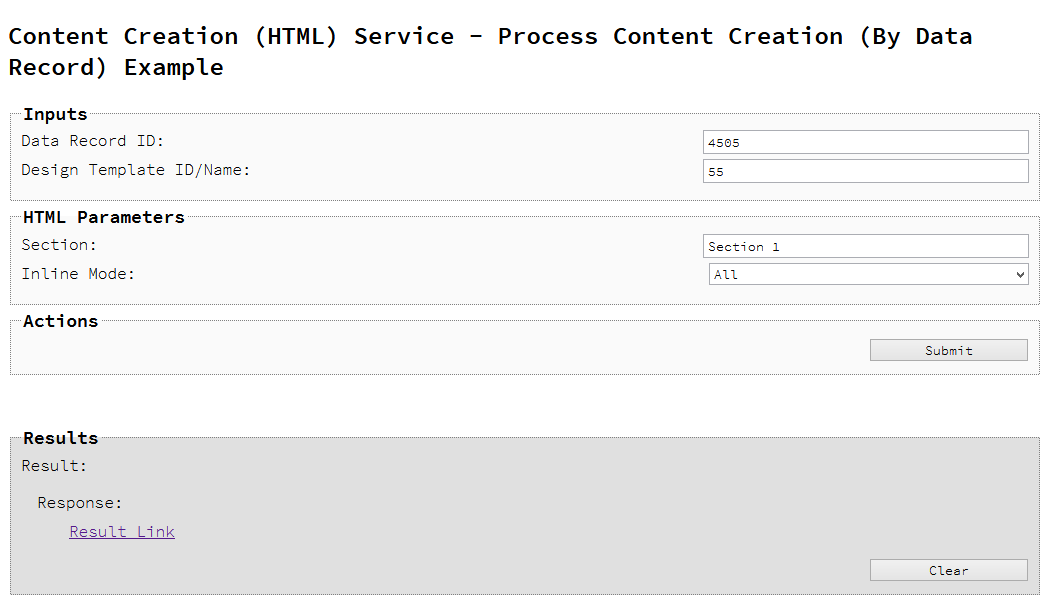

To run the example you first need to enter your Data Record ID and the Managed File ID or Name of your design template (previously uploaded to the file store) into the appropriate text fields as your inputs.
Next you need to specify the HTML parameters to use when creating the web content:
  • Section – the section within the Web context of the template to use
  • Inline Mode – the inline mode to be used in the creation of content

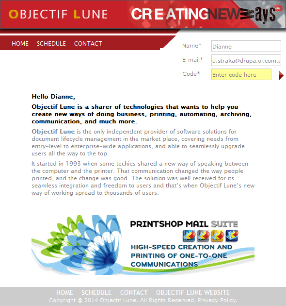

Lastly, select the Submit button to create and retrieve the web content. When the response returns a Result Link will be displayed in the Results area. This link can be selected to view the resulting web content that was created.
