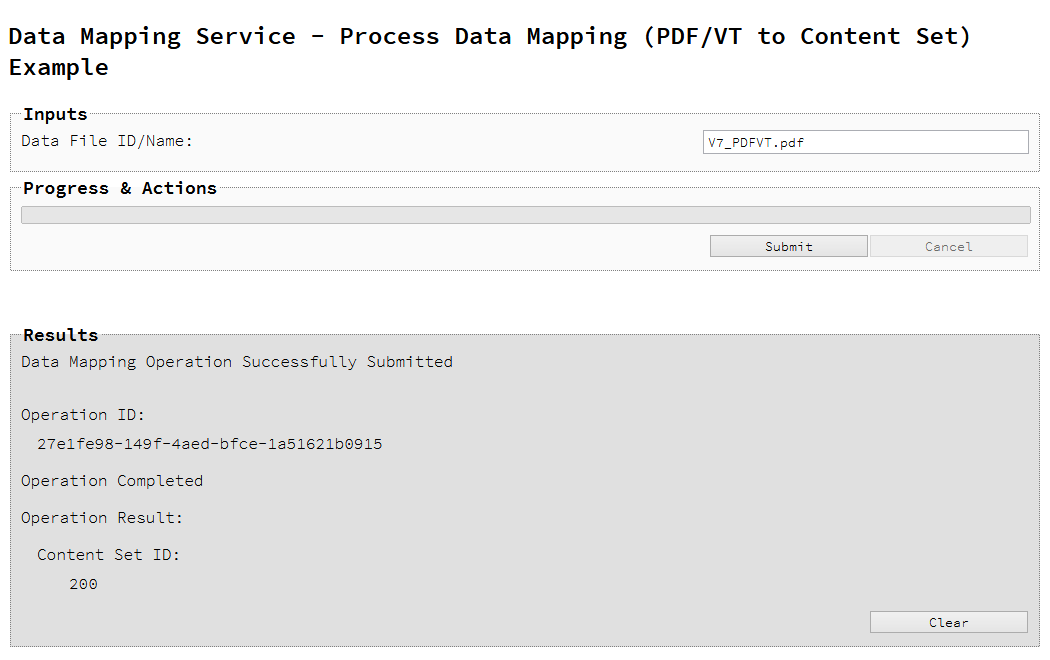

Screenshot & Output
Usage
To run the example simply enter the Managed File ID or Name for your PDF/VT file (previously uploaded to the file store) into the appropriate text field, and then select the Submit button to start the data mapping operation.
The progress of the operation will be displayed in the progress bar, and once the data mapping operation has completed, the ID of the Content Set created will be returned and displayed to the Results area.
