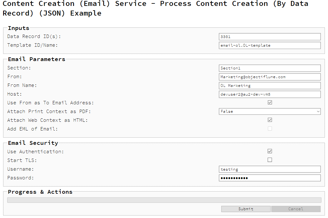

Screenshot & Output
Usage
To run the example you first need to enter a comma delimited list of your Data Record IDs and the Managed File ID or Name of your design template (previously uploaded to the file store) into the appropriate text fields as your inputs.
Next you need to specify the email parameters to use with the content creation operation:
  • Section – the section within the Email context of the template to use
  • From – the email address to be shown as the sender in the email output
  • From Name – the name to be shown as the sender in the email output
  • Host – the network address or name of your SMTP mail server through which the emails will be sent. If required, a server port value can also be specified
  • Use From as To Address – use the sender address as the receiver address for all emails in the output
  • Attach PDF Page to Email – if a Print context exists in the template, create it's output as a PDF and attach it to the email output
  • Attach Web Page to Email – if a Web context exists in the template, create it's output as a single HTML web page (with embedded resources) and attach it to email output
Then you need to specify how email security is to be used with the content creation operation:
  • Use Authentication – if authentication is to be used with the mail server
  • Start TLS – if Transport Layer Security (TLS) is to be used when sending emails
  • Username – the username to authenticate/login with
  • Password – the password to authenticate/login with
Lastly, select the Submit button to start the content creation operation.
The progress of the operation will be displayed in the progress bar, and once the content creation operation has completed, a report of the emails successfully sent will be returned and displayed to the Results area.
Further Reading
See the Content Creation (Email) Service page of the REST API Reference section for further detail.
