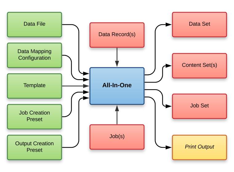

All-In-One
The All-In-One process embodies all four major workflow processes (data mapping, content creation, job creation and output creation) in a singular process. It can be configured to run one or more of the four processes, as long as the processes specified result in a logical sequence or workflow.
Depending on it's configuration, the All-In-One process can produce either a data set, content sets, a job set or print output (Print context).
The following diagram illustrates the potential inputs, outputs and workflows for the All-In-One process:
.png)
The following table lists the available processes, input combinations and expected outputs for the All-In-One process:
Processes | Input Combination | Expected Output |
Data Mapping Only | Data File + Data Mapping Configuration | Data Set |
Data Mapping + Content Creation | Data File + Data Mapping Configuration + Template | Content Set(s) |
Content Creation Only | Data Records + Template | Content Set(s) |
Data Mapping + Content Creation + Job Creation | Data File + Data Mapping Configuration + Template | Job Set |
Data Mapping + Content Creation + Job Creation | Data File + Data Mapping Configuration + Template + Job Creation Preset | Job Set |
Content Creation + Job Creation | Data Records + Template | Job Set |
Content Creation + Job Creation | Data Records + Template + Job Creation Preset | Job Set |
Data Mapping + Content Creation + Job Creation + Output Creation | Data File + Data Mapping Configuration + Template + Output Creation Preset | Print Output |
Data Mapping + Content Creation + Job Creation + Output Creation | Data File + Data Mapping Configuration + Template + Job Creation Preset + Output Creation Preset | Print Output |
Content Creation + Job Creation + Output Creation | Data Records + Template + Output Creation Preset | Print Output |
Content Creation + Job Creation + Output Creation | Data Records + Template + Job Creation Preset + Output Creation Preset | Print Output |
Output Creation Only | Jobs + Output Creation Preset | Print Output |
