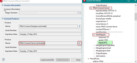

To check if you have a PCL Input license:
- Open the Connect Software Activation module.
- Click on the "i" icon next to the PReS Connect Server product.
- When the License File Details window opens, expand the PReS Connect Server, then expand the DataMapper node. If the Inputs.PCL entry is present in that node, you have a PCL Input license.

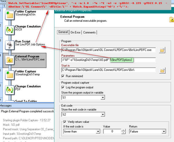

To set advanced conversion parameters, the PCL input file has to pass through an additional Workflow process before entering the process in which the data mapping takes place. The extra Workflow process should call the LincPDF command line module LincPDFC via the External Program plugin with the desired advanced conversion parameters. To create such a Workflow process:
- Add a local variable to your process and name it lincPDFOptions.
- Add another local variable named workingDir and give it a default Windows path (for example: C:\PCL2PDF\).
- Add a plugin to capture the PCL File. You may use any input plugin that imports the PCL file into the process, such as Folder Capture, LPD Input, etc.
- Using the Change Emulation plugin, change the Emulation to ASCII. This type of emulation allows to set the number of lines per page, remove or add lines or even remove some HP PCL escape sequences if necessary.
- As the number of options you pass to LincPDFC may be high, it is recommended to assign all the desired options to the local variable lincPDFOptions. To do that you can use either the Set Job Infos and Variables plugin or a Run Script Action plugin, for example with the following JavaScript:
Watch.SetVariable("lincPDFOptions","-z:1 -*e -*f -u3 -s -pXOff:-0.155 -pYOff:0.15 -dAuthor:\"OL Connect\" -dTitle:\"" + Watch.ExpandString("%O") + "\"");
This example sets the following options or parameters: -
Next, use the External Program plugin to convert the PCL to PDF with the above %{lincPDFOptions} options.
In the General tab:
- Set the Executable file to: C:\Program Files\Objectif Lune\OL Connect\LPDFConv\Bin\LincPDFC.exe
- Set the Parameters to: -i"%F" -o"%{workingDir}\Temp\%O.pdf" %{lincPDFOptions}
- As a minimum, LincPDFC requires an input file, which is set here via the parameter –i to which we are assigning the current job file path and name “%F”, and an output file path and name set here using the –o parameter with a dynamic value of "%{workingDir}\Temp\%O.pdf".
- Select the "Run minimized" option to run the program in the background
- You may select to Log the program output for additional troubleshooting. This is optional; however when activated LincPDFC detailed conversion will be added to the Workflow log.
- Save the output of LincPDFC using the –o folder specifier in the parameter (%{workingDir}\Temp, in this case.)

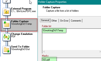

In another Workflow process, import the created PDF with the Folder Capture input plugin, specifying the output folder of the previous process (%{workingDir}\Temp in the example) as input folder, and %O.pdf as the file mask.
Once you have the PDF as job file, you may pass it to the Execute Data Mapping plugin for further processing.

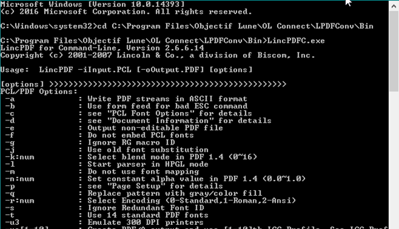

To view the available options that can be set in LincPDF, run the executable (LincPDFC.exe) in a command prompt window. It will display a help message with available options.
/*Open Windows Command Prompt
Change directory
cd C:\Program Files\Objectif Lune\OL Connect\LPDFConv\Bin
LincPDF for Command-Line, Version 2.6.6.14
