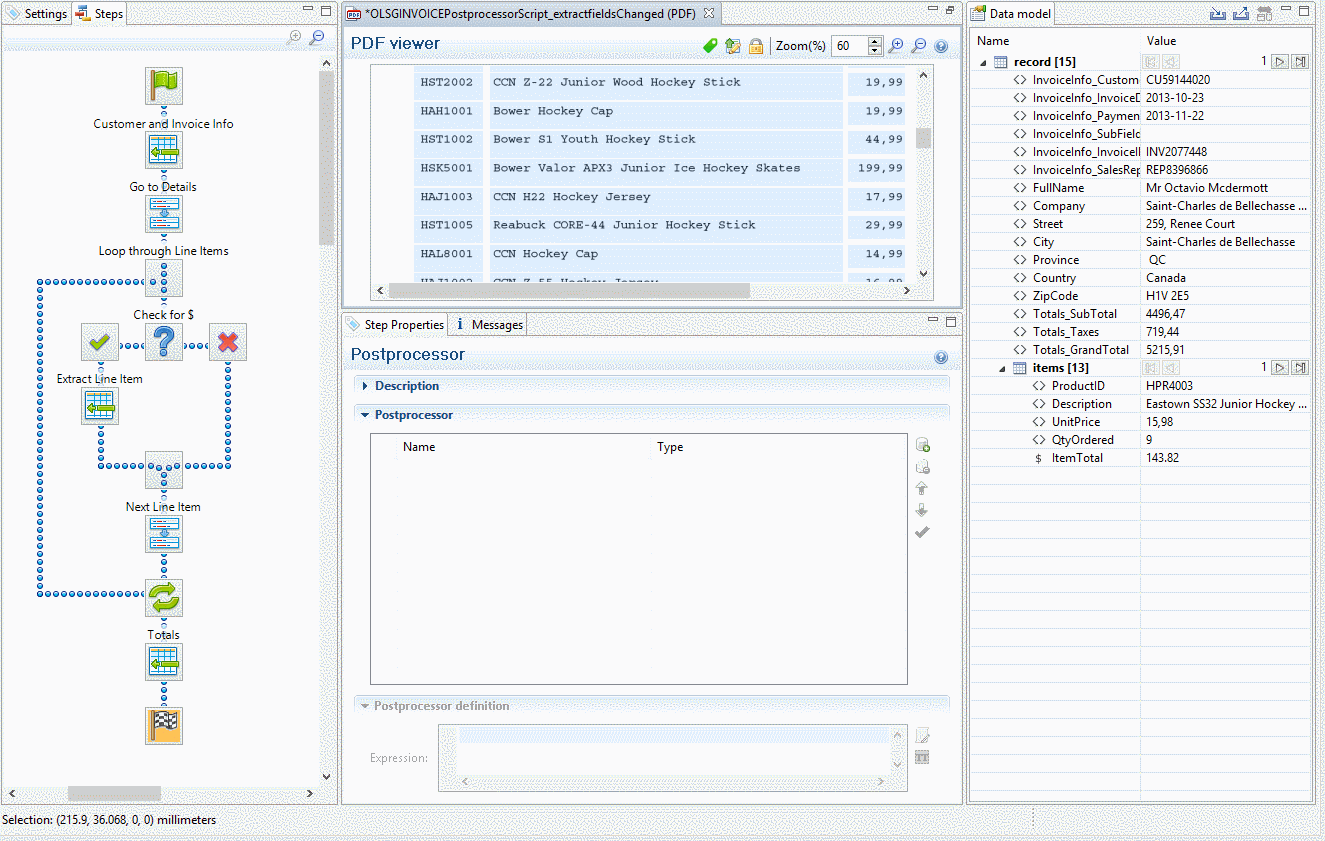

Select the Postprocessor step on the Steps pane.
On the Step properties pane, under Postprocessor, click the Add button
Under Postprocessor definition, add the script. Postprocessor tasks must be written in JavaScript (see Using scripts in the DataMapper and DataMapper Scripts API).

Post-processors are not executed automatically while designing the data mapping workflow. The reason for this is that post-processors can potentially be quite lengthy operations that would hinder the automatic refresh of the display whenever anything is changed in the data mapping workflow.
In order to test post-processors you must execute them manually by clicking the Apply button in the Post-processor step properties (see Postprocessor step properties).
Note that in the DataMapper and Designer, only one data record is active at any given time. Therefore, the changes made by the post-processes are only visible on the current data record (i.e. the one currently displayed). If you change data records, you must press the Apply button on the Postprocessor step once more.
In order to test a case with multiple records you must either use the data mapping configuration in a print job through the Designer or in the Execute Data Mapping task in Workflow so that all records will be processed by the Postprocessor step.
