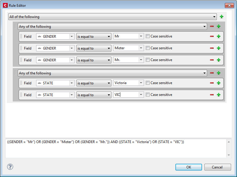

The following example shows a test to return all the adult males in the state of Victoria. It might not capture all the males (as the dataset does not contain this specific data), but it at least allows us to extract all those we can, with the information available to us:
