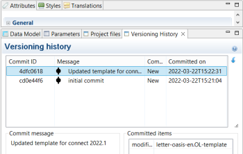

Viewing Project History
The Project History contains the records for all of the changes made to each resource in the project. When you commit a project, a snapshot of the project resources is stored as a version. You can review the versions to see what changes were made, who made them, and when they were made.
To see the history of the project:
  1. With the project open in Designer, select Project > Versioning history from the menu bar.
  2. The history displays in the Versioning History tab.
You can select a version from the list to display more information about the changes made in that version.
To restore a previous version, select the version, then select the restore icon. The project is reset to the state it was in when that version was committed.
