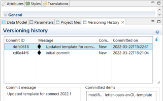

Use the Versioning History option in the Project menu to display the history of all changes. The Versioning History panel contains a complete record of who did what, on which date, and for which reason.
You can elect to revert to a version from within the history if something turns out to be flawed in your current project.
