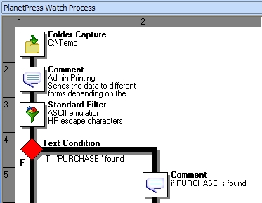

The numbers on the left in the Process area indicate the task index.
In the above image, the Folder Capture task is on level 1 and the Text condition is on level 4.

  3. From the Task index box, select the index level to which you want the data to be sent. The index is the position in the process where you want to submit the job file. The numbers on the left in the Process area indicate the task index.
