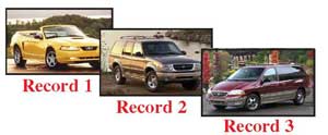

Example: Image filename is "As is".
If your database contains a field that already has the name of the image you want do display including the extension, you can refer to it directly in the image's expression. For example, if your database has a field called "Car Pic", you could simply use the expression [Car Pic] in your expression.
| ZIP | CAR | CAR PIC |
| 91335 | Mustang | Mustang.jpg |
| 75038 | Explorer | Explorer.jpg |
| 60173 | Windstar | Windstar.jpg |
| 33351 | Explorer | Explorer.jpg |
Result:
Example: Condition triggered by the contents of a data field.
If your database contains a small trigger that can be used to dynamically determine what image will be displayed, you can use a condition in the expression to determine what image will be shown depending on that trigger. For example, if you have a field called "Car Type" that contains either A, B or C which refer to a specific car type, you can use that.
