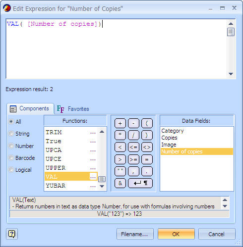

  1. Double click on the VAL function from the function list. The expression will be pasted into the Expression Edit field.
  2. Select the string value of the database field containing the number of copies.
    View   the Expression Editor

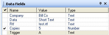

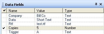

In this case, the data field does not contain a number string, but it does have a field to be used as "Trigger".

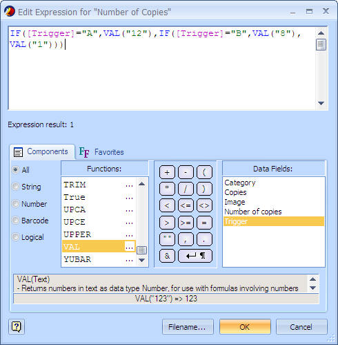

In the expression "IF([TRIGGER]="A",VAL("12"),IF([TRIGGER]="B",VAL("8"),VAL("1"))) ", the field name "TRIGGER" has either an "A" or a "B" in it. The number of copies for "A" would be 12, and the number of copies for "B" would be 8. At the end of the expression, you need to add VAL("1"), because the function must result in a numeric value.
