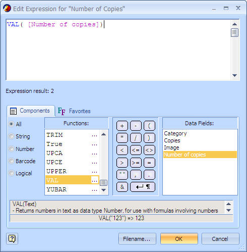

PrintShop Mail allows you to print a number of copies per page. The Expression Editor can be used to generated multiple copies of each page in your document.
Once the Expression Editor is open:

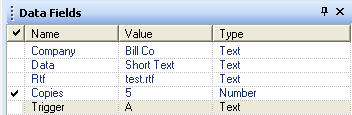

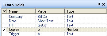

In this case, the data field does not contain a number string, but it does have a field to be used as "Trigger".

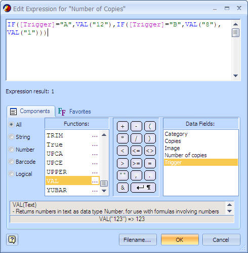

In the expression "IF([TRIGGER]="A",VAL("12"),IF([TRIGGER]="B",VAL("8"),VAL("1"))) ", the field name "TRIGGER" has either an "A" or a "B" in it. The number of copies for "A" would be 12, and the number of copies for "B" would be 8. At the end of the expression, you need to add VAL("1"), because the function must result in a numeric value.
Note: When you use layout condition SKIP for your PrintShop Mail documents with multiple layouts, or when you have applied variable Number of Copies, this may cause that the size of the record sets (the number of actual printed layouts per record) will be different per record set. This in turn may cause that some record sets will be split across different stacks.
