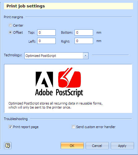

  To specify print job preference settings
  1. (Windows): From the Edit menu (CTRL+K), select Preferences.
    (Mac OS): From the PrintShop Mail menu (Command,), select Preferences .
  2. In the left pane, click the Print Job Settings icon.
View   the window
About print job preferences
Set this option... To do this...
Print Margins Print Margins are empty spaces all around the page. The margin (top, bottom, left, right) is usually the empty space between where the page is cut and the layout area of the page.
PrintShop Mail allows you to make changes to the print margin for all layouts in the document. It is possible to:
  • Center (Windows only): Where the layout(s) will be centered on the paper.
  • Offset: Where you can specify different values for each print margin: Top-Bottom (Y offset) and Left-Right (X offset).
  • Note: PrintShop Mail supports different paper sizes within one document. Print Margins settings will be applied to the whole document.
Technology Select which print technology is used to optimize your PostScript output. See Print Technologies for more information on these options.
Print report page Specify that a report page is printed at the end of the job.
Send custom error handler (Windows only) Specifies whether a Postscript error will generate a custom error page containing tips on how to solve the problem. Leave this box unchecked if you want your printer to handle any errors.
