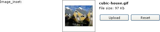

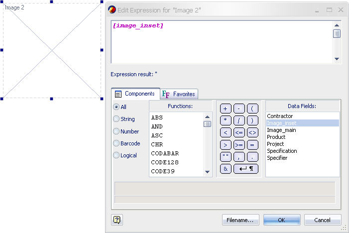

The Image Upload field type enables the end user to upload an image file for the job. The PrintShop Mail document should contain a variable image box, with an expression that refers to a (user input) data field. The Scale property of this box defines how the image is resized relative to the box. Make sure that the Source of the data field is set to User Input. For more information about variable images refer to the Designer Guide.
The supported image formats are: JPEG, GIF, PDF.
An image upload field
The Image Upload field has the following parameters:
Required: Defines the image upload option as a required field requireing upload an image.
Separator Line: Controls whether a separator line will be shown before this field. With this option web forms that have more complex variable data can be arranged more logically.
The image box in PrintShop Mail Design, the expression of this box is referring to a data field
