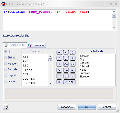

A layout condition to skip or print a layout, in PrintShop Mail Design
