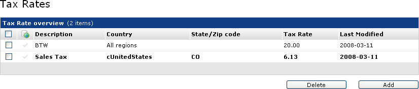

The Tax rates overview shows all available tax rates
To define a tax rate as the system default tax rate click the grey check mark in front of the tax rate description (name). The default tax rate has a black check mark in front of the tax rate description.
