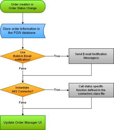

MIS connectors add functionality to the PSM Web order creation and order status change processes. The following diagram outlines these processes.
Order process flow diagram
The system performs the following tasks:
  1. Order information is stored in the PSM Web database.
  2. The system defines if email notification messages should be send.
  3. The system checks for the active MIS connector, if found the functions of this connector are called.
  4. The user interface (UI) of the system is updated.
