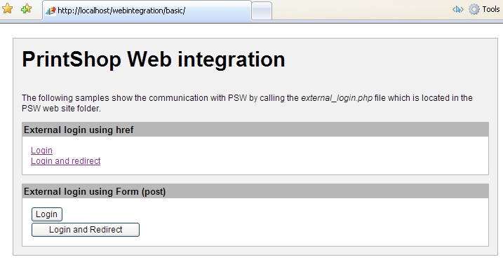

Examples are included with your PrintShop Mail Web installation and can be found in the webintegration folder of the PrintShop Mail Web web site folder. The sample below is taken from the index.php stored in the basic folder.
<!-- Sample href --> <a href="external_login.php?fcUserName=administrator&fcPassword=administrator">Login</a> <!-- Href with redirect --> <a href="external_login.php?fcUserName=administrator&fcPassword=administrator&fcPageID=storefront_overview">Login</a>
<!-- Sample form --> <form method="POST" action="external_login.php"> <input type="hidden" name="fcUserName" value="administrator"/> <input type="hidden" name="fcPassword" value="administrator"/> <input type="submit" value="Login"/> </form> <!-- Sample form including redirect --> <form method="POST" action="/external_login.php"> <input type="hidden" name="fcUserName" value="administrator"/> <input type="hidden" name="fcPassword" value="administrator"/> <input type="hidden" name="fcPageID" value="storefront_overview"/> <input type="submit" value="Login and Redirect"/> </form>
The basic webintegration index.php file
