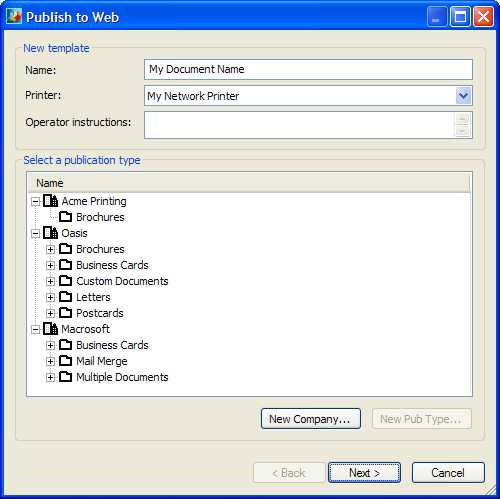

When using the Publish to Web feature from PrintShop Mail Design, depending on the rights of the user that is publishing the document. The following window is from PrintShop Mail Design:
As you can see, two buttons are available under the list of publication types:
When you click on Next, PrintShop Mail Design will prepare the files and then send them to PrintShop Mail Web (refer to the PrintShop Mail Design User Guide for more details on this process). Note that by default any new document you send to PrintShop Mail Web is disabled so you will need to enable it for clients to use them. If you create a new publication type or a company, they will also be disabled by default.
