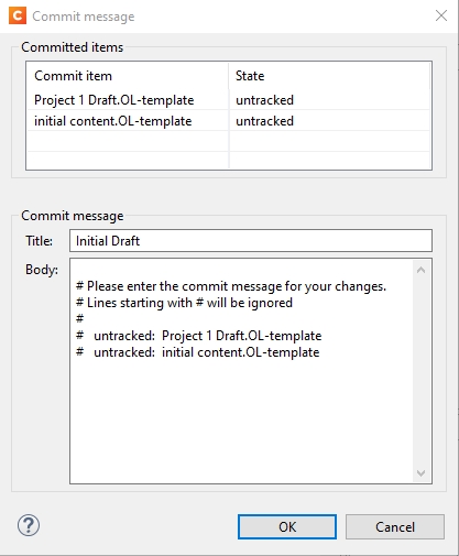

To record this version in the repository, select Project > Commit. This records the project files as a new version in the repository. Remember to save any changes before you commit.
Note: The .gitignore file in the project folder tells Git which subfolders and files should not be committed.
Enter information to describe the changes, then select OK. Describing the changes is important as it will allow you, later, to readily identify each version as you browse through the project history.

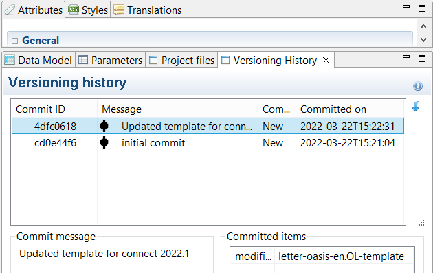

The project history contains the records for all of the changes made to each resource in the project. When you commit a project, a snapshot of the project resources is stored as a version. You can review the versions to see what changes were made, who made them, and when they were made.
To see the history of the project:
With the project open in Designer, select Project > Versioning history from the menu bar.
The history displays in the Versioning History tab.
You can select a version from the list to display more information about the changes made in that version.

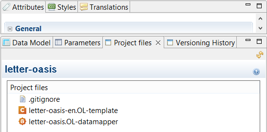

Select the Project files option from the Project menu to display the list of resources in the project.
The files comprising a project display in the Project files panel.
