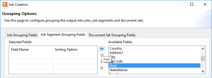

  2. On the Job Segment tab, select the data field State in the Available Fields list.
  3. Click the blue arrow to add the selected data field to the Selected Fields area.

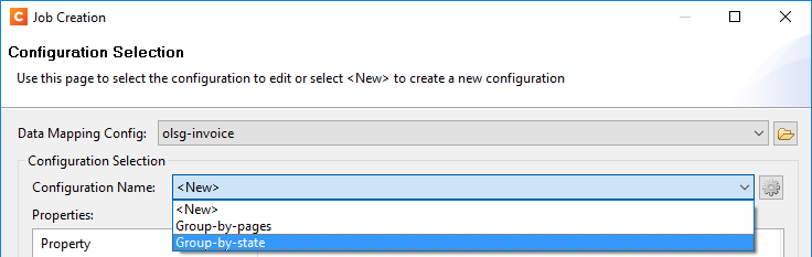

  1. Open the Group-by-state Job Preset in the Designer: select File > Print Presets > Job Creation Settings… and choose Group-by-state from the Configuration Name drop-down list.
