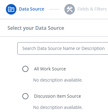

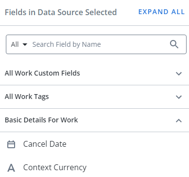

  3. Select a Data Source from the list:
    Tip: After selecting a Data Source, the Data Views that belong to it will be previewed in the "Fields in Data Source Selected" panel on the right-hand side. Expand any of the views to see which fields are available:

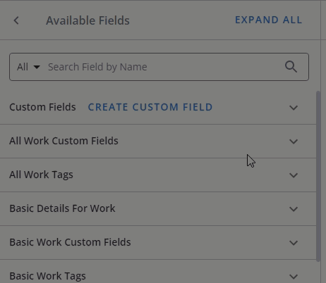

  6. Expand the Data View that contains the field(s) you would like to include in your report:
    Click thumbnail to play.
    Tip: Use the search bar to find certain fields if you are unsure which Data View they belong to. Alternatively, see Data Sources and Views for lists of each Data Source and their related views and fields.

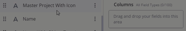

  7. Use the six dots to drag and drop the fields that you would like to use in your report from the "Available Fields" section to the "Columns" bucket on the right:

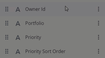

    Tip: Instead of dragging and dropping, fields can be moved to buckets by selecting the three dots on the right-hand side of the field:
    Note: To use an existing custom field, click the Custom Fields drop-down menu and drag and drop an existing custom field to the bucket on the right:
    To use a new custom field, click Create Custom Field. See Create a Custom Field from the Upland Analytics Help Center for more info.
    These are not to be confused with PowerSteering Custom Fields.

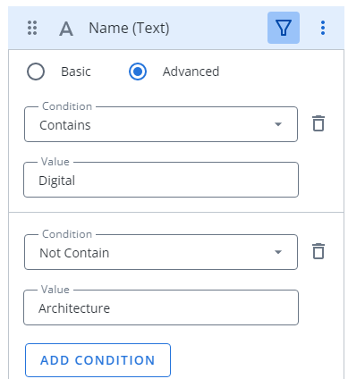

    Note: Two types of filters can be added to a field: Basic and Advanced.
    Basic: These filters are based on keywords. If the value for the field contains the keyword exactly as it is typed, the item will be included in the report. For example, this filter will only include Projects that have the word "Digital" in the name:
    Advanced: Multiple conditions can be added to these filters through the drop-down menus. For example, a condition can be added to include the word "Digital" in the Project name, same as above:
    On top of this, another condition can be added to prevent Projects with "Architecture" in the name from appearing in the report:
    For more information on field filters, see Apply a Filter to a Field in the Upland Analytics help center.

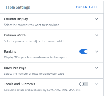

  13. Adjust the settings of your report using the left-hand panel:
    Note: The available settings will depend on the Report Type you originally chose. See Report Settings in the Upland Analytics help center for more information on settings by Report Type.
